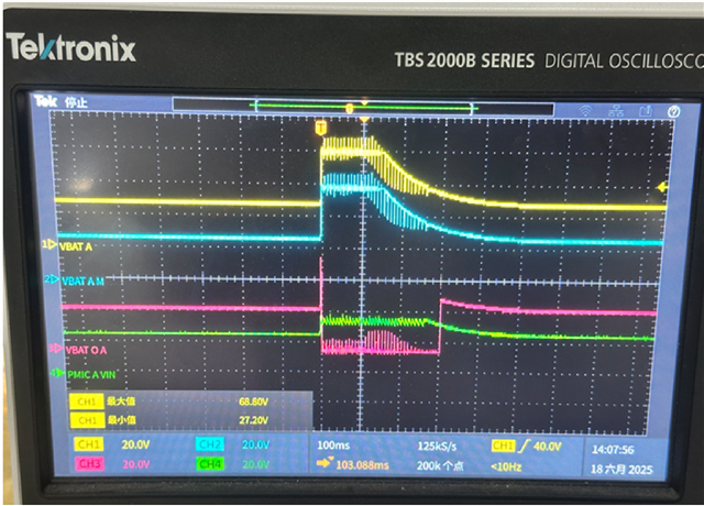

Hi  Texas members:

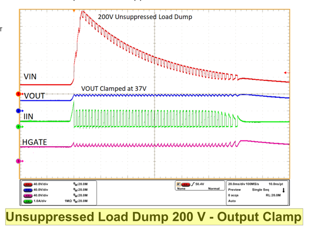

    I found that in LM74930-Q1 datasheet, there was a photo about Unsuppressed Load Dump 200 V - Output Clamp,  but in LM74910 datasheet, there was no such kind of test picture.

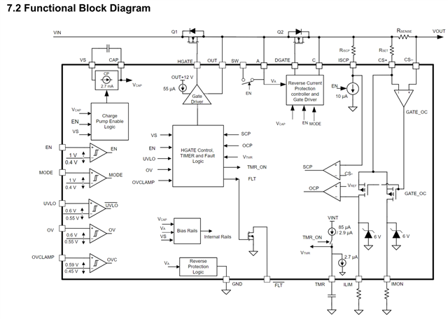

What's the difference between LM74930-Q1 and LM74910-Q1?  I didn't find TVS or something clamping in LM74930 block diagram, how can it clamp dump voltage?
