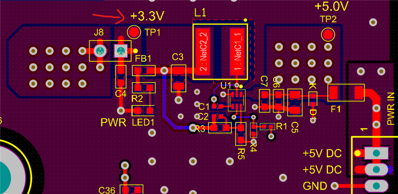

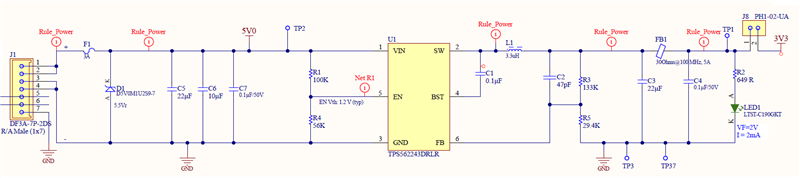

Will the TPS562243 IC enter thermal shutdown under the following conditions?
IC rating is up to 2A.
  • Output: 3.3V @ 1.5A
  • Input Voltage (Vin): 5V
  • Ambient Temperature: 30°C - 40°C
Additionally, we would appreciate recommendations on how to minimize heat buildup and ensure reliable thermal performance.
Attached schematic and layout screenshot.
