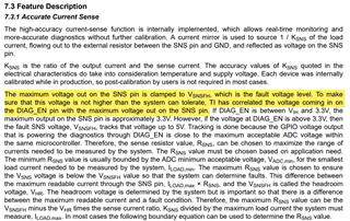

I am using the TPS1HTC100 ic for controlling the auxilary power. I am going with a max load of 5.7A, my Rlim would be 8Kohms. And to avoid saturation at my 3.3V microcontroller i am going with a Vsns(max = @5.7A) = 3.1V. So then the load current is 5.7A the Vsns would be 3.1V, my Rsns = 435ohms. but what is there is a short circuit and the current exceeds that ? will the output voltage on the sns pin go above the intended 3.1V and if yes then how can i protect the microcontroller that can take a maximum of 3.3V on its input pins ?

    If you are concerned about a short to ground scenario on the output, then that should not affect the SNS pin. A short to ground fault will cause the SNS pin to output VSNSFH but this voltage is scaled based on what diagnostics is pulled high to. So, if DIAG_EN is pulled high to 3.3V then that is the highest voltage that SNS pin should see. Please see below for a more detailed explanation.
    Please also keep in mind the typical nominal load current for this device is about 4A and other factors like temperature, board layout, etc. to make sure the device does not go into thermal shutdown. Also, RILIM can only be between 10kΩ–50kΩ.
