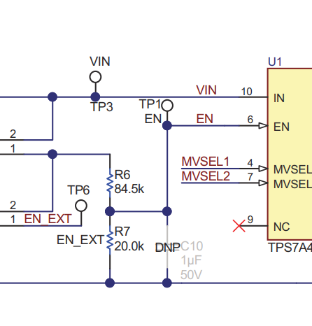

Hi team,
Can they connect the EN pin to MVSEL2 pin? The MV output voltage is 12V. and The resistor divider is same value as EVM below.
Shoo
Hi team,
Shoo
Hi Shoo,
The MVSEL pins are digital inputs with a threshold voltage of 0.9V. Since the minimum Enable threshold of 1.15V is higher than this, MVSEL may be connected to the same voltage as the EN pin.
