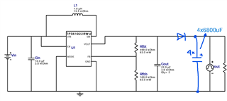

The datasheet gives 1000uF as "Effective output capacitance range".
We will use the TPS61022 to raise a voltage to 3.6V with 2.5A, this circuit need to power our electronics board that has on the power input 4 capacitors in parallel of 6800uF. Is this a problem that may cause a problem on the feedback or instability of the converter?
If is the case adding a diode in series between the output of the TPS61022 and the capacitors can solve the problem?
