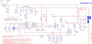

I'm using the LM5033 to modulate a DC voltage for transformer-based isolation, serving as part of a safety barrier mechanism.
However, we're observing switching noise that degrades EMI performance, and we're looking to mitigate it.
Currently, OUT1 and OUT2 are configured to switch at approximately 160 kHz, supporting a load of around 1 A. The system is powered with 24 V at VIN and 12 V at VCC.
We believe we’ve adhered to the recommended layout guidelines and have implemented several mitigation techniques: decoupling capacitors are in place, snubber networks have been added on the transistor gates connected to OUT1 and OUT2, and series gate resistors are also included.
We're considering whether adding a ferrite bead on the VIN line could improve EMI performance. Based on your experience, have you found this approach to be effective? If so, could you recommend a specific ferrite bead model? We're also open to any other improvement suggestions you might have.
    You need to measure the noise / spikes and find what their frequency and magnitudes then according to these to help select a ferrite bead.
    Layout is another area to look at to see any improvement can be made.

    We have done investigations prior to this inquiry so we have pretty good control of the design utilizing the LM5033, but we are left with the mentioned switching noise.  Might be we still can optimize the layout or snubber network.  However, we wonder if possibly a filter on the VIN power line might have any impact.
    Please provide your switching waveform so I can help further. I am not sure what is 160kHz frequency - which it looks it is a converter operation frequency which usually not able to use to ferrite bead to reduce its magnitude. Ferrite bead usually is used for much higher frequency noise like mega Hz on top of 160kHz.
    It is helpful you show the waveforms to help understand your issue to resolve - as it seems I cannot understand what you want to make attenuation as your description is not in line as I know in general. So the waveforms can help my understanding.
  • The LM5033 is a push-pull, voltage-mode PWM controller that provides alternating outputs (OUT1/OUT2) to drive external MOSFETs. These outputs are square wave signals set to operate at 160 kHz with a 50% duty cycle in my circuit.
    As with most switching regulators, switching noise is a known challenge during EMC testing. In this circuit, the 160 kHz switching frequency and its harmonics contribute to the EMI observed on the power line.
    However, after reviewing application notes and other documentation from TI regarding the LM5033, I haven’t seen ferrite bead on VIN being recommended. That’s why I initially brought this up. Let’s close this topic for now.  I’ll continue investigating it on my own. Thanks.
