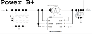

Hi Experts,
Good day!
May need your help on SCH review for my customer.

Hi Marsh,
We would recommend using a 33V TVS to withstand the unsuppressed load dump instead of 26V.
Rest, the schematic looks fine
