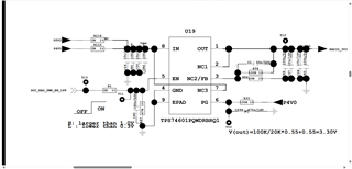

Hi Experts,
Good day!
May need your help on SCH review for my customer.
BRs,
Marsh
Hi Marsh,
Pins 2 and 7 are NC. Either keep them floating or ground them for better thermal performance.
All else looks good.
Ishaan
