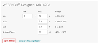

I am looking to have a negative Vout using the LMR14203. I am looking to step down 30V at Vin to -5V at Vout. I tried using the power designer tool to create a topology for me, but it didn't allow output ranges in the negatives. Is there some work around regarding the external circuitry that would allow me to see -5V at the output?

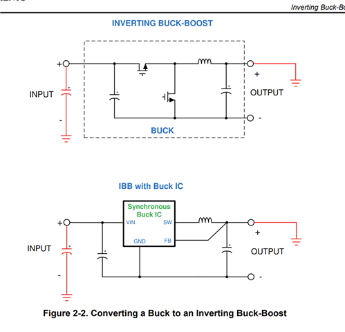

Does following something like the schematic below work for this device for obtaining a negative Vout?

    30 to -5V would be possible using this device, only concern is there is not enough margin for Vin swing. For this application you would device which supports Vin > Max input voltage + |-Vout|. If long cables are used to power up the device, Vin seen by the device could exceed recommended operating max.
    Additionally, WEBENCH design of this device doesn't support Vout below 0.765V

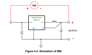

    I would recommend using PSPICE for TI here. You can refer simulation section of same app note for work around

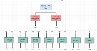

  • I plan on creating a board like so:
    I want to use the bucks to create +- 24V rails that can be used as the supplies to LDOs that can produce various voltage supply rails. Particularly, the loads that will attach to the supply rails (output of LDOs) are going to typically consume less than 50mA. Additionally, the LDO that supplies 5V will also be used as Vin to the REF2033 and REF35 (which consume <= 20mA each).
    The current capability of the TPS739 is 150mA but in my use case, devices that will connect to the supply rails won't use that much and will consume at most at around 50mA. For the max current load, it depends on how many devices are connected to the rails and how much current those device are going to consume at most.
    The IBB would be the LMR516x5 that produces a -24V rail
  • Hello Justin
    Thanks for sharing this!
    How many devices you plan to put on -24V rail? Evaluate current stress on the device accordingly as discussed in the section 4.2
