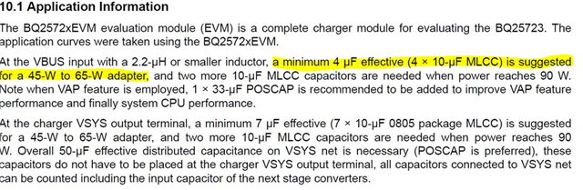

From the BQ25723’s application information, could you help to share how do you define the minimum 4μF effective? This suggested capacitance is based on what kind of test condition? Thanks.
At the VBUS input with a 2.2-μH or smaller inductor, a minimum 4 μF effective (4 × 10-μF MLCC) is suggested for a 45-W to 65-W adapter

  • Hi, Brian,
    The minimum 4uF is assured by design, and verified on bench to be stable for 45W to 65W power level. Note 4uF is effective capacitance, after DC bias derating curve. Since this is input capacitance, which is suitable for 1S to 4S battery configurations. Please refer to the BQ2572XEVM for implementation guide.

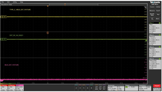

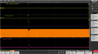

  • Hi Tiger
    could you help me check below waveform from customer side is ok for you? I think the Vin drop more than 5%.
    Attaching VIN drop waveform for reference. EXT_DC_IN_C6321 is VIN of BQ25723
    When they add 25V 100uF electrolytic capacitor we can see the waveform is improve.
    and we find only some type-c adapter will happen as below PN
    customer side key concern is they need to know when BU side calculate the effective capacitor. do you also think the corner as above adapter which capacitor may be very low?
    BRs
    Brian
  • Hi, Brian,
    It looks the customer can add more input capacitance.
