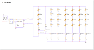

TPS54201: Schematics verification
Part Number: TPS54201
Other Parts Discussed in Thread: TIDA-01586
I am using the TPS54201DDCR to drive 28 IR LEDs (2 circuits 850nm and 940nm IR LEDs). Please review the schematic and share your feedback.
Design details:
Vin: 12V
For the 850nm IR LEDs:
  • Forward voltage per LED: 1.5V
  • Total forward voltage per string (4 LEDs): 6.0V
  • Forward current: 42.5mA
  • Sense resistor: 4.7 ohm
For the 940nm IR LEDs:
  • Forward voltage per LED: 1.3V
  • Total forward voltage per string (4 LEDs): 5.2V
Inductor: 1mH (calculated requirement was 580uH, but 1mH is used due to availability)
Let me know if you see any issues or have suggestions for improvement.
