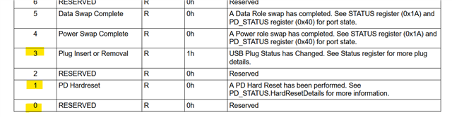

We set the IRQ mode in the binary of the PD, which caused the GPIO7 pin of Airoha (the pin connected to the I2Ct_iRQ pin of the PD) to be continuously pulled low. After successfully loading the patch, we reset the 7 Interrupt Clear for I2C1 Register (Offset=18h) register, but it still reads a low level. We would like to ask if there is a way to set its GPIO7 to a high level?

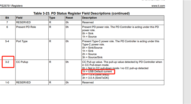

Secondly, after resetting the 0x18 register, we read 0x18 again, and the 0th, 1st, and 3rd bits were set to 1
Read 0x40 register, the 2nd bit is set to 1
Are these values causing the IRQ to be consistently lowered?

  • You are supposed to read register 0x14 and write the values of the 0x14 to 0x18 to clear the interrupts.
    0x40 is status register which is independent of interrupts.
  • Hi Ghouse,
    After successfully loading the patch, we read the 0x14 register and found that Bit0,1,3 was set to 1. Then, we set Bit1,3 in the 0x18 register to 1 (Bit0 is reserved), which means we wrote 0x0A to the 0x18 register. After reading the 0x14 register again, we found that Bit1,3 was still set to 1 and the interrupt was not cleared
    The second test was to set Bit0, 1,3 in register 0x18 to 1, and then read register 0x14. It was found that Bit0, 1,3 were still set to 1 and the interrupt was not cleared
