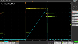

    Double Pulse test example with UCC23513, Rg=5 Ohms
    CH1= Vgs
    CH2=Id
    CH3=Igate
    CH4= Vds
    Eon Measurement:
