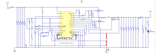

Hi
I am Bhavik.  Tech Lead (HW) at Adventus Meditech.  I have used LM5148 IC for 24V to 12V buck converter.  Output current rating is 10A.
When I activate all the loads on 12V, DC DC converter faces issue in power up.  But if DC-DC converter is powered up and then apply load, it is working fine.  I check VCC and VDDA and both are at 5V.  Can you help me to debug this error?
I am attaching complete schematic here.
