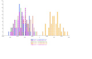

The leakage at PGOOD is 0.1mA, which is significant when it's about reducing the standby. Knowing this is a worst case value, please give a supporting graph to estimate the applicable value.

I have found some measurement data which show a distribution over temperature.
So typically the current is much lower but has some drift on high temperature.
Stefan
Hi Stefan, I didn't quite catch what the x-axis data is. I'm looking for the current at 25, and 110 degC, let me know if u have any specific data on this.
Hi Aiswarya,
x Axis is the the measured leakage. y-Axis is the amount of devices where this leakage as been measured.
Colour and pattern marks the Temperature. BIAS was 8.5V.
Stefan

the BIAS voltage in this context is the voltage applied on PGOOD (so the BIAS voltage of that Pin) - not the voltage on the BIAS pin of the LM5176.

Stefan, I see I've made a mistake in the conversion, although I don't usually :) The 100nA get converted to 0.1uA not mA as I have incorrectly mentioned at the starting of this chain. Forgive me for taking up ur time, yes,I got to know better about the parameter and that helps. Thank u for assisting.
