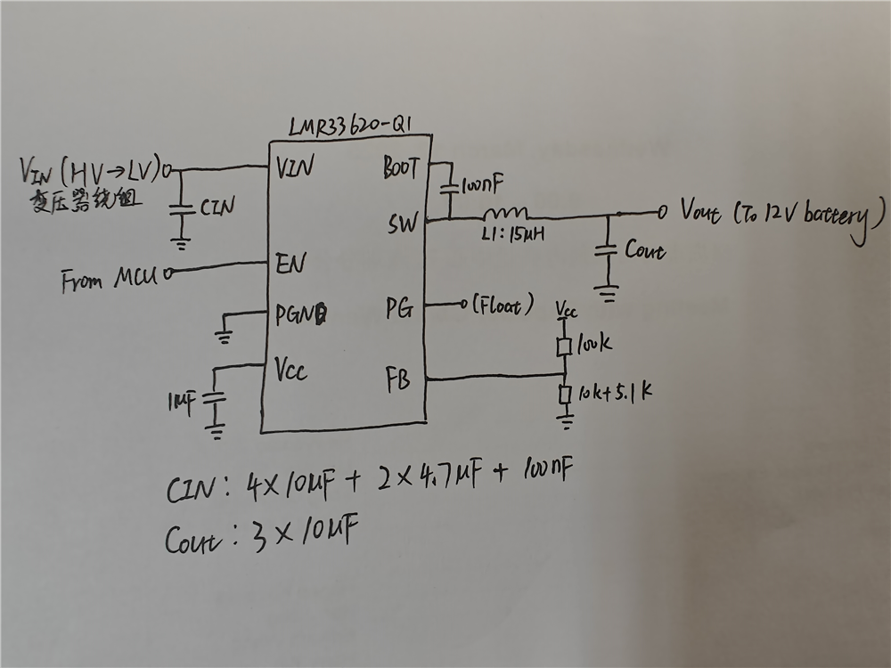

My customer (CosMX) is looking for a suitable device which functional block diagram is closed to LMR33620-Q1, and meet below request. Is LMR38020-Q1 the most suitable device?
  • MAX input voltage: 60V.
  • Output voltage: 5V
  • Output current: 2A.
