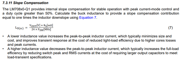

When I take a look at the duty cycle, it is not stable and move from low duty cycle to high duty cycle and it really looks like subharmonic oscillation. So as I have not access to the value of the slope compensation, I decided to modify the quality factor Q of the transfer function by modifying the value of the inductor. So I decided to  increase the inductor to reduce the resonnance responsible of subharmonic oscillation. I confirmed this by a simulation and it effectively reduce the resonnance. I placed a 68uH and then a 150uH. The problem is still the same and it seems that the inductance has no effect on the problem. I also desperately tried to place a 22uH. The problem is still the same.
