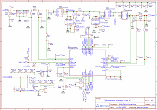

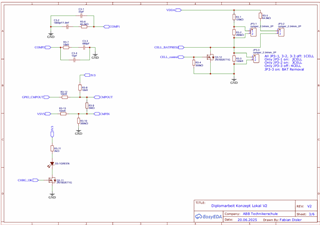

Dear Texas Instruments Support Team,
I am a student from Switzerland and for my thesis I am currently working with a BQ25703A
I am trying to operate my system without a battery connected, primarily for testing purposes.
Problem:
I am seeing a voltage drop across MOSFET Q2-1, which is driven by HIDRV1. I have 5.2V before the MOSFET, but only 1.3V after it. This indicates that the MOSFET is blocking the voltage.
A schematic of my setup is attached for your reference.
Question:
What configuration settings are necessary to allow the voltage to pass through Q2-1 and reach VSYS, enabling system operation without a battery? Which registers and bits control this?
Goal: I want to power the system connected to VSYS from the input source even with no battery.
The CELL_BATPRESZ pin is currently Permanently tied LOW.
Future Intention:
I also plan to use the BQ25703A with a 4-cell battery pack in the future. Is the attached code snippet suitable for a 4-cell configuration, or will register values need to be changed?
I have attached a snippet of my current initialization code below:
I would appreciate any guidance you can provide to resolve this voltage blocking issue and ensure proper system operation without a battery.
Thank you for your time and expertise.
Sincerely,
Fabian
  • Hi, Fabian,
    Your schematic looks similar to the BQ25703AEVM.
    The board should power up without register write. It loads the default settings during startup.
    To operate without battery, suggest setting charge current to zero.
    If there is no system output, it could be some hardware issue. Suggest ordering a BQ25703AEVM and following the user guide for your first charger project.

  • Hi Tiger,
    Thank you for your reply.
    Yes, I used the EVM board as a reference.
    I checked the schematic of the evaluation board and noticed that a jumper (JP5) was missing, which I have now added. The chip is starting up, but the output voltage is only 3.17 V, which is too low for my application.
    Do you have any ideas on what might be causing this?
    Thank you in advance!
    Fabian
  • Hi, Fabian,
    Please make sure the cell_batpresz pin was set correctly, such as 4S.
    Tiger
  • Hi Tiger,
    Yes, you were right. There was a problem with the cell_batpresz, but I have fixed it now.

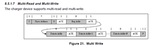

  • Hi Tiger,
    Thank you for your response, and apologies for my late reply.
    I found the issue in the code—the register within the set_charge_current function was written in the wrong order.
    Currently, my BQ25703A is charging my battery, but the current is very low.
    pi@raspberrypi:~ $ i2cget -y 1 0x6B 0x29
    0x03
    In my opinion, this indicates approximately 192mA.
    Do you have any suggestions or solutions for my problem?
    Fabian

    Do you have any idea why this might have happened?
    Fabian
  • Hi, Fabian,
    I think you may connect the battery in reverse polarity. My suggestion is to follow BQ25703AEVM user guide.
    User guide bq2570x Evaluation Module PDF|HTML
    Tiger
