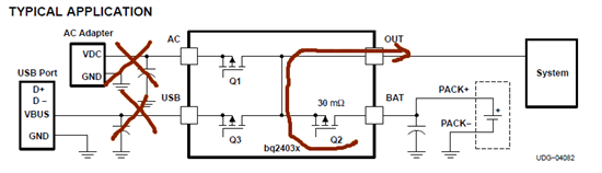

Hi,everyone
when bq24032 do not get power from AC or USB,can battery supply power to system through bq24032 as the picture below?Thanks in advance.

Yes, please read data sheet; this is the most basic function.

Hi,Charles
After removing AC and USB,shoud the CE pin be high?I do not want to use microtroller to control the CE pin.So how can I keep the CE pin high?
Thanks in advance.
Stones
Hi,Charles
when battery discharge through BQ24032,the CE pin should low or high? In other words,can battery discharge through BQ24032 if CE pin is low?I can not found this material in the datasheet.
Stones
the CE pin is like a usb suspend.....it is a don't care when only the battery is connected.
Hi,Charles
So when only the battery is connected whatever CE is high or low,the MOSFET Q2 is turned on.In other word,the chip still work.It get power from BAT pin.Is it right?
