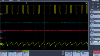

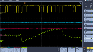

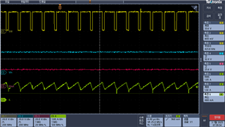

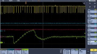

  • Thank you for reply.
    Please refer to schematic and waveforms below.
    No load
    Load 1A

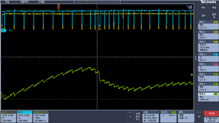

    Load 1A, Vin is gradually lowered to 26.2VDC (Noise occurs in the section below)
    The basic circuit configuration is the same as the LMR51635 EVM, and Cff and compensation are being reviewed.
    When L is 15uH, double pulse is observed in SW and increases to 22uH.
    Additionally, although it did not seem to be observed in the DC power supply, when DC power supply Vin is gradually lowered and approaches 26.2VDC, IL is observed to shake.

    It looks like you are hitting min toff of the IC. Typical value for Min Toff is 200 ns for this device. for 24Vout, approximately you would hit min Toff operation around ~26.1V and IC would gradually reduce the frequency. Check 7.3.4 Minimum ON Time, Minimum OFF Time, and Frequency Foldback for more details. Could you please measure frequency at SW with 26.2 Vin
    Additionally, could you please check CB-SW waveform when IL dropped suddenly? I assume load was held constant during this instant.

    My current hypothesis is that the bootstrap capacitor (CB) is discharging below the UVLO level, causing the device to turn on the internal low-side FET for a longer duration to recharge it. This would explain what we see in your captured waveform, where SW is low for a duration longer than the minimum Toff time.
    To confirm this, please capture the CB-SW waveform using a differential probe. This will help us verify if the bootstrap capacitor voltage is indeed dropping too low. If this turns out to be a bootstrap capacitor UVLO issue, there is limited scope for improvement. In that case, you'll need to reduce the input voltage ripple by adding more filtering on the input side.
