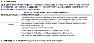

We are using BQ34Z100-R2 to create a golden image.
To create a golden image using constant current charging and discharging, I checked the TRM and changed the "Load select"  to 0.
So, I have a question.
Because the golden image ran a learning cycle at a constant current, I set Load select to 0, but if it is to be incorporated into an actual device, I think Load select 1 would be appropriate.
In this case, is it okay to run the learning cycle with Load select set to 0 and then change Load select to 1 in the golden image created?
Or would it be better to re-acquire the golden image by running a learning cycle by charging and discharging at a constant current with Load select set to 1?
Which one is recommended?
