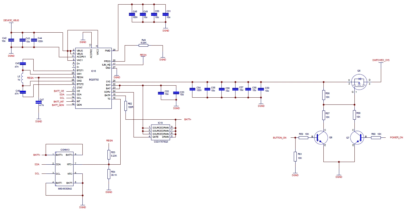

I am developing a new instrument which includes the BQ25792 to manage the battery charging and USB power.
We have been working with the first prototype PCB's and had 3 with apparently failed BQ25792's.
This is the charger part of the schematic:-
This is the charger layout:-
The VBUS comes from a 5V 2.5A USB charger. The battery is a 21700 2S1P 7.2V 4.9Ah.
We rely on the SYS output to power the rest of the circuit.
A button connected to SYS at BUTTON_ON turns Q5 on, then a PIC holds it on at POWER_ON until the system is turned off.
When we get this failure, the SYS output just stays at close to 0V with VBUS connected, the battery connected, or both.
We suspect it may be related to a register setting we are applying, but cannot pin it down to a particular one.
It may also only happen when a battery is connected. Running just on VBUS hasn't caused the failure as yet.
Registers we were setting are:-
CHARGER_CONTROL_1,0 - DISABLE WATCHDOG TIMER
CHARGER_CONTROL_0,176 - ENABLE ICO
CHARGER_CONTROL_5,183 - ENABLE SHIP FET; ENABLE IBAT DISCHARGE CURRENT SENSING FOR ADC; ENABLE BATTERY DISCHARGING CURRENT OCP
PRECHARGE_CONTROL, 198 - 240mA
MINIMAL_SYSTEM_VOLTAGE, 18 - 7V
CHARGE_VOLTAGE_LIMIT, 840 - 8.4V
CHARGE_CURRENT_LIMIT, 50 - 500mA
INPUT_CURRENT_LIMIT, 300 - 3A
ADC_CONTROL, 0x8c - ENABLE ADC; 15BIT; START AV USING NEW ADC CONVERSION

  • Hi Julian,
    I don't see any issues with the registers. BQ25798 and BQ25792 are pin 2 pin and reg 2 reg compatible.  If charge can be disabled with either CE pin or bit when there is no battery or open pack protector due to discharged battery, then BQ25792 is okay. Otherwise BQ25798 is best because it does not turn off the converter for 30ms after BAT OVP, causing SYS collapse, like BQ25792.
    On these failures, does the IC restart after power cycle or are the ICs damaged?
    Jeff

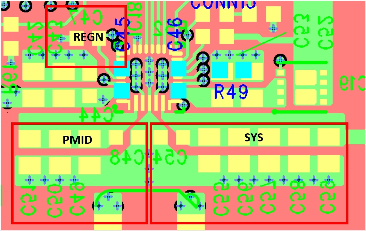

    Both /CE pin = low and CE pin=1 is required for charging.
    I am surprised by the damaged IC with such low power application.  Your layout looks ok.  Most important caps are the REGN, PMID and SYS caps.  Their voltage rating should be at least 2x their applied voltage to account for derating. Their ground returns to IC GND pin need to be short, low inductive traces/pours.
    Jeff

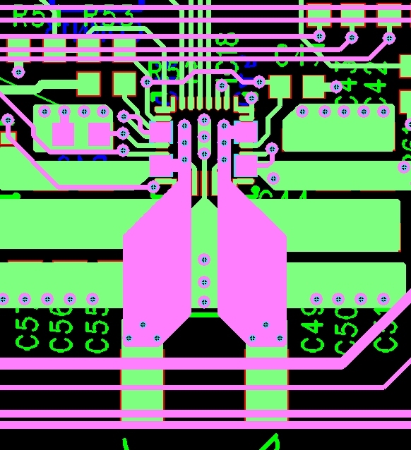

  • Hi Jeff,
    I have reviewed the capacitors I am using. All PMID and SYS capacitors are 25V X7R. The REGN is a 16V X7R. I have checked the BQ25792EVM BoM and that uses a 16V X5R on REGN and 25V on the others except the 100nF's which are 50V. I was intending to change them all to exactly the same as the EVM on the next iteration of my board.
    In terms of the ground returns the PMID and SYS capacitors connect to a copper pour on the same side as the charger. The REGN capacitor ground however is connected to a ground plane layer. See below:-
    What do you think?
    Julian

  • Hello Julian,
    Once again, thanks for being patient with this.
    This layout looks good. Also, it might be good to make the top GND plane larger to also include the REGN capacitor.
    Just for reference, we generally recommend closely following the example layout in the datasheet for the BQ25798.
    Ethan Galloway

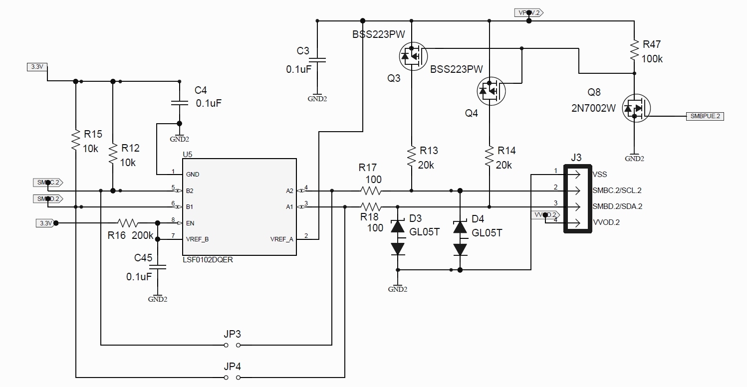

    They have recommended putting protection on the comms lines, something like this extract from your EV2400 circuit:-
    I was going to put the TVS diodes on all lines I am taking to our micro-controller as a precaution.
    What do you think about this?
    Have you heard about this problem?
    Julian
  • Hi Julian,
    I haven't heard of this problem but protection on the comm lines definitely will not hurt.  With no battery or open protector, the BQ25798 clamps the BAT voltage to ~2.4V*# of cells for about 1.5 seconds while applying the trickle charge current = 100mA to close the pack protector.  But after 1.5s, the charger starts a full charge cycle. If the pack protector has not closed by then, the pack input sees the full battery voltage.  Maybe there is capacitive coupling to the lines?
