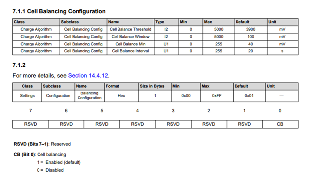

Hello.
I set BALANCING CONFIGURATION (0x460f) CB (bit0) = 1 .
but in BQstudio, BAL_EN bit in Gauging Status is still 0.
How can I change the bit, BAL_EN ?
There is no command for BAL_EN in command window.

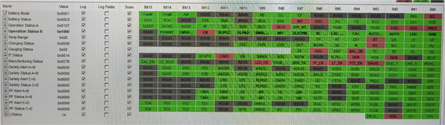

  • Okay, I found the way to change BAL_EN bit (only charge mode can support balancing, right?)
    but still CB bit = 0 with cell balancing start condition,
    what should I do for it?
    refer attached filescheck CB.gg.csv

    The BAL_EN bit just indicates that cell balancing is active. For the BAL_EN bit to get set, the cell balancing configuration parameters must be met, and the CB bit must be set. Please refer to the BQ4050 TRM for the cell balancing operation.

  • Hello, I already know about yout guide.
    My BQ4050 set BAL_EN and my cells are in imbalanced status,
    but I don't know why CB bit doesn't change 0 to 1.
    (means not processing CB)
    please check with attached log and gg file.
    I am not sure I fully understand what you are asking here. The CB bit is something that you change, not the gauge. This bit can be changed by using the data memory tab, or by directly writing to the Balancing Configuration register.
    Jonny.
  • Dongoh Kang probably meant the OperationStatus()[CB] bit...
    I am not sure what the issue is here. It looks like the CB bit is set. If you have any confusion on when a specific bit is supposed to be set, how a bit is supposed to be set, or what a certain bit does, please refer to the device's Technical Reference Manual. This is described in the Technical Reference manual.
