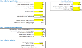

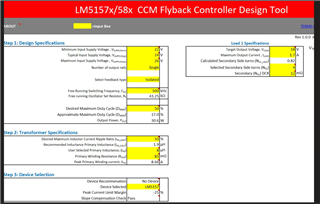

  • Hi Feng Ji,
    Unfortunately, the LM5157 series (LM515x) doesn’t seem suitable for my application. These devices are unable to handle the required peak primary current. They only work in cases where the secondary turns are kept below 2, which is not practical in my design.
    I’ve attached a screenshot for your reference. Could you please have a look and let me know if I’ve made any mistake in my analysis? or could you suggest for any other solution for my application?
  • Hi Manjesh,
    You need to reduce the turn ratio to reduce the primary peak current. Another note is to start from 100-400kHz.
    However, we have around 20% peak current margin here.
    You may consider LM5156 (with external FET) if you want to have more margin in peak current.
