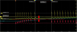

we test the LM5160 EVM board. we can find the PWM signal of chip is stop during power supply start-up; stop time is about 40us;
the peak current value of transformer primary side is about 430mA;
why dose the chip output stop?
  • Yellow is PWM(sw pin);
  • Blue is output voltage;
  • Green is FB pin;
  • Red is transformer primary side current;

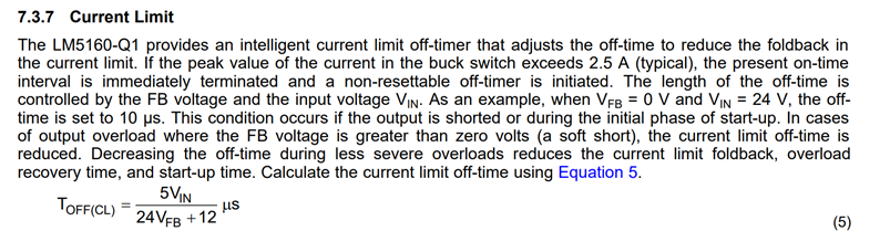

    Please go through the datasheet section 7.3.7
    The length of the off time is controlled by the FB voltage and the input voltage VIN. As an example, when VFB = 0 V and VIN = 24 V, the off time is set to 10 µs. This condition occurs if the output is shorted or during the initial phase of start-up.

    That's the point, I don't understand;because we used the current probe to measure the peak current (pin12&pin11 output current);it's about 0.43A, which is well lower than the limit value in datasheet (2.5A).
    yes,in my test case, the off time is 47us; so,then we use the EVM board to test with min modification. but EVM still have off time(less than 47us);
    We want to know why it have this off time,because  we also used the current probe to measure the peak current for EVM board. and don't found big current value which can go up to limit of 2.5A.

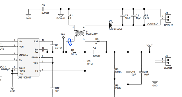

      Where are you exactly measuring current? please confirm if you have checked between IC pin11/12 and T1 pin 1 like this. Also, can you please attach
      waveform of iL with good resolution with A/div, BW info etc for proper understanding? Sorry I cannot see iL_peak level due to poor resolution.

      1)but we don't find the condition of when VFB = 0 Vand VIN = 24 V,  for both my board and TI EVM board;(The red arrow is shown in the image);
      this is why i don't understand this issue;
      don't  have VFB = 0 and don't exceed the limit of 2.5A; why does EVM have about 10us off time ?
      2) for waveform of iL with good resolution with A/div, BW info etc;This may be due to the website, my image became blurred after uploading.
