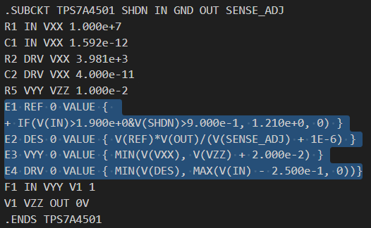

It appears that the PSPICE transient model is encrypted and will not work outside that software. Unlike many of our other chips, we have not released a fully unencrypted PSPICE model for this part. The TINA model .lib file, however, is not encrypted but also not in the LTSPICE format. You could likely make it work by manually converting the 4 voltage dependent voltage sources from the TINA syntax to the LTSpice syntax:
LTSPICE: https://ltwiki.org/LTspiceHelp/LTspiceHelp/E_Voltage_Dependent_Voltage_Source.htm
Essentially: I would try changing VALUE {<expression>} to value={<expression>} and try importing that modified netlist

Hello Gregory,
I see that the lib file contains few resistors and capacitors that are connected between different nodes such as IN, VXX, DRV, VYY.
First of all, could you tell me please what is the purpose of those resistors and capacitors, because I didn't find them in the datasheet.
Secondly, could you tell me please the meaning of VXX, VYY, VZZ, DRV, and DES nodes?
Thank you,
Marius
Hi Marius,
It's quite an old and idealized model that should simulate the part's basic properties but won't necessarily reflex the real internal structure. Many things are added as extreme values to ensure convergence and efficiency.
Though this model was made before my time, a basic rundown on it's structure:
The resistors and capacitors don't correspond to anything physical or that you'd find in the datasheet but are part of the way the device is modeled. R1,R2,C1,C2 form a resistor divider a smooth resistor divider between IN and DRV and are given quite extreme values to minimize their impact on the rest of the circuit. R5 is part of the way it outputs voltage. VXX VYY and VZZ are arbitrary internal nodes. VXX is the output of the voltage divider, VYY and VXX are part of the way it outputs voltage. DES is the output of the feedback function, DRV is basically the output of buffer from DES the with some limit behavior for what I believe is dropout.
