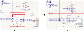

Hello, when I was using the BQ25750, the path could not be switched under load conditions. I found the relevant solution from the previous forum, which stated that the BATFET should be connected to the SRP side of the resistor. When used in this way, the path switching is fine. However, the charging current is different from the set value. When the setting is 1A, it is only around 500mA. What should I do in this situation? Can the resistor be removed directly? Or are there any other solutions?

  • Hi Ethan,
    These are some scenarios and conditions about my system operates.
    1. This picture shows the changes in the connection of BATFETS to the BQ25750 resistor in the system.(From A to B)

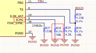

    3. I used the register to set the ICHG current.

  • Hello Jianbo,
    Thanks for the new information.
    I think the ICHG pin might be getting noise on the pin. Can you install an RC filter in parallel with the ICHG resistor? We recommend this the ICHG resistor is greater than 5kΩ.
    To diagnose this, can you set ICHG_REG = 2A and EN_ICHG_PIN=0 in the registers? This will disable the ICHG pin. If the IC outputs the correct current, that means the ICHG pin is the root cause of the behavior.

    1. When my BATFETS bypasses the SRP of RBAT_SNS and directly connect  SRN, will RBAT_SNS still be effective?  What other functions does RBAT_SNS have?
    RBAT_SNS will still be used to regulate the battery charging current.
    2. If RBAT_SNS has no other functions, can this resistor be removed and the SRP and SRN be directly connected instead?
    The system will still need RBAT_SNS.

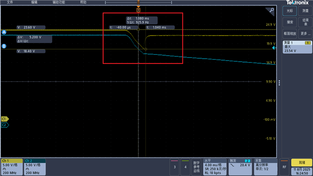

  • Hello Ethan,
    Sorry, during the testing process of the routing system, the path switching failed.
    We conducted the test using an oscilloscope.
    When the power supply is cut off, the power is switched from the main power source to the battery. There will be a drop in voltage, as shown in the red box in the figure (yellow line).
    Is there any way to optimize this phenomenon? So that the circuit can switch more smoothly, similar to a downward slope.
    Is this phenomenon related to the parameter Vvacuvp that we have set?

  • Hello Jianbo,
    Thanks for working on this.
    Setting the ACUV voltage a bit higher may help.
    I have a few suggestions:
    • If the IC is only going to be in buck-only mode, you might be able to use a single FET and use ideal diode mode
    • Can you use auto reverse mode? Auto reverse mode has a faster response time than the battery FETs. Once the voltage stabilizes, you can go back to turning on the BATFETs.

  • Hello Ethan,
    emmm...When I set a higher ACUV value, the charging voltage must be increased accordingly. Otherwise, charging will not be possible. Is this correct?
    During the testing process, when I changed the ACUV setting from 20V to 22V, charging could only occur when the input voltage was greater than 24.5V. At this point, the system has been operating for more than 24 hours without being disconnected.
    When I further reduced the ACUV voltage from 22V to around 20.6V, charging was possible with an input of 24V, but the system would cut off the power supply within 24 hours.
    1.The external input voltage for our equipment is 24V, and the battery is composed of 6 strings(19.2V~25.2V). Not only does it operate in the buck mode.
    2. We hope that it can automatically switch to battery power supply without the need for software control when the external power source is removed. May I ask for any suggestions?

  • Hello Jianbo,
    It sounds like the BQ25750 is in VAC_DPM? Can you measure the voltage on the ACUV pin? The pin will be near 1.21V if the BQ25750 is in VAC_DPM.
    Also, do you know what the charge current is while the IC is in this mode?
    We have an FAQ on ACUV and ACOV that goes into more detail on this.
