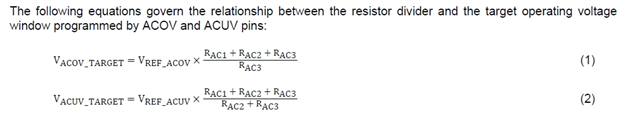

2, the following formula does not understand, what does this target voltage mean? How should I determine this target voltage
    The target voltage is dependent on your application. VACUV_TARGET is the voltage you want for your input undervoltage protection, and it is usually the lower limit of the input voltage source in the design. VACOV_TARGET is the voltage for input overvoltage protection. For a 12V nominal input voltage, choosing 8V for VACUV_TARGET and 16V for VACOV_TARGET will limit the operating range of the device between 8V and 16V.
    This FAQ page for the ACUV and ACOV pins might explain things a little clearer.

    3. ACUV and ACOV are related to the reverse mode. The operating voltage of our product is 9~16V. Now it is necessary to configure the window voltages of ACUV and ACOV through resistors. How should it be configured? For example, when ACUV is reduced to 7V, the reverse mode is automatically turned on.
    This design calculator should help choose the values for ACUV and ACOV:
