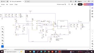

As we are using the module TPS53015 as in our design for the application of 12V to 5V, we are not getting Expected output voltage as 5v, in this query i am sharing the Schematics we have used to get the 5V from the 12V
input.
In the schematics, VCC_SRC_FET is 12V,
please let us know, is there any wrong with the design
  • Any help on this

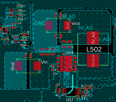

    Pls share the Layout. is there any other leakage path for Vout and FB on the board?
    Vref in you measurements show higher value than the datasheet spec
    can you replace the IC with working TPS53015 or a new IC to see if it is related to layout

    please find the layout,
    can you replace the IC with working TPS53015 or a new IC to see if it is related to layout      ---- I have replaced with new IC, but still same response getting 0.8V from at Vout.

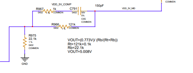

    I had measured the components values in the feedback circuit. Everything as expected.
    R966 is 121K, R967 is 1K, C791 as per your suggestion i have changed to 10pF, but when measuring R975, i should get 22.1K but getting nearly 2.3K, even i have changed with new 22.1K resistor, when i am measuring across it with DMM again it is showing 2.3K only.  may IC internal circuit parallel to it?

    Since we are not seeing the expected VFB / VOUT ratio set by the R966 and R975 divider, we need to conclude that something is in error with the divider.
    Then the board is not powered, the VFB pin should not be leaking enough current to measure 2.3k from VFB to GND, but if the VFB to GND resistance was really 2.3k instead of 22.1k, the output voltage would be higher, not lower, and we should see a larger VFB to VOUT ratio, so I don't think that is the problem.
    Check the GND connection R975 to make sure it has a good solder connection and good connection to ground.  If R975 is not connected to GND, that would create the issue we are seeing.
    Use a DMM or Ohmeter to measure the resistance from the GND terminal of R975 to another ground point on the board in order to verify that R975 is connected to ground.   The resistance should measure under 1Ω
    Check the VFB connection of R975 to make sure it has a good solder connection.
    Use a DMM or Ohmeer to measure the resistance from the VFB terminal of R966 to the other ground point on the board.  This will confirm the resistance of R975 and it's connection to VFB.  The resistance should measure 22.1k (or at least, it should be the same as measuring across R975) this will check the connection from VFB to R975 and the connection from R975 to GND.
    There might be a bad solder joint on R975, or a bad ground via from R975 to ground.

    In the meantime, I have performed some resistance measurements using a DMM:
    • R975 GND Check: I measured the resistance from the GND terminal of R975 to another known ground point on the board. It shows 0.7Ω, which confirms that R975 is properly connected to ground.
    • R966 VFB Path Check: I measured the resistance from the VFB terminal of R966 to the same ground point. It reads 2.3kΩ.
    Due to this reading, I suspected the value might be off, so I replaced R975 with the actual 22.2kΩ resistor. However, after mounting, it still shows 2.3kΩ, which is unexpected.
    Please let me know your thoughts or if you'd like me to check anything else.
    Sai Kiran
  • I agree, that is unexpected. but suggests that there may be something else connected to the VFB net that might be sourcing current into VFB.
    Can you try removing R975 and measure the resistance from VFB to GND?
    You should also be able to turn the converter on with R975 removed, though the expected ouptut voltage would be .773V with R975 removed.
    I have removed and tested, Gettting Vout as 0.773 and VFB is 0.812V

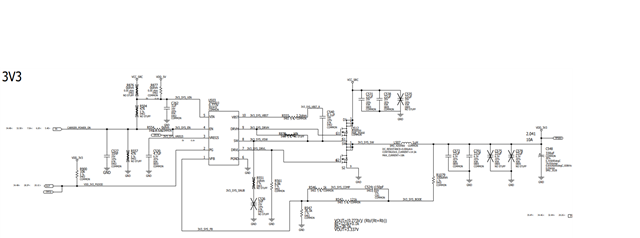

  • i will checked the soldering on the PCB, is fine.
    i want to share you one thing here, we have used TPS53015 in same PCB for the 3.3V output application. that is working fine.
    this circuit is giving 3.3V output.
    placement wise and soldering is same for the board circuits.
    FYI, our board is custom carrier board for NVIDIA jetson AGX orin SOM.
    thanks,
    SAI KIRAN
    Can you try swapping the TPS53015 controllers between the two locations to see if the issue follows the device or the application location?
