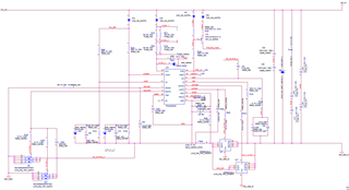

Hi Guy
We have used TPS23523 solution to design hotswap & ORing.
Our electrical parameters are as follows~~
Pin : 780W
Vin : 54V+/-10% ( 48.6V ~ 54V ~59.4V)
Iin : 16A
Cin : about 470uF
Question
1、If the OR-ing FET is designed with GaN (EPC2304 & EPC2307), is there any side effect?
Using EPC2307 (or EPC2304)  GaN 2pcs parallel design OR-ing.
If the output capacitor is 470uF, does this design meet the SOA specification?
 GaN datasheet is attached.
2、Our electrical parameters are as follows~~
Using SPR8010S-C Mosfet 2pcs parallel design Hot swap.
Mosfet datasheet is attached.
EPC2304_datasheet.pdfEPC2307_datasheet.pdfSPR80N10S-C.pdf
