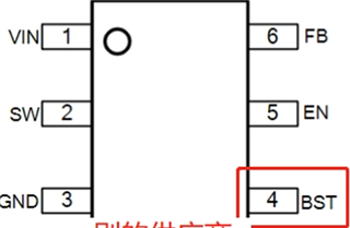

I've only found TPS563252 p2p with below device, but it only has 3A. Do we have 4A device p2p with below?

Hi Haseen,
tps564257.pdf has PG on 4pin, not BST. Please help find 17V 4A SOT-563 buck with BST on 4pin.
Sienna
Hi Sienna,
We don't have a part with Pin 4 as BST with 4A output.
