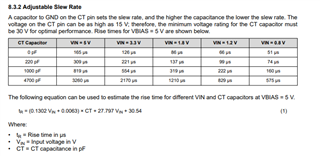

What is the relationship between the value of CT and the output rise time?
