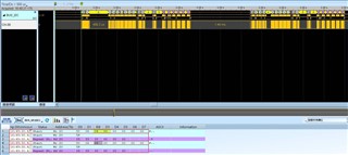

    6. Plesae kindly review our .pjt file and schematic that is there any error for our configuration, we have no idea how to judge the I2C data is right or not;

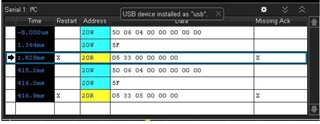

    7. We read the I2C single and logic analyzer for the type-C Forward and backward insertion waveform:
    8. The .pjt for your evaluating, and can you help to provide the right . pjt configuration to us, thanks.

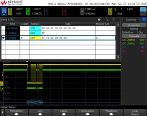

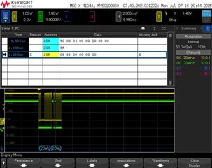

    3. Plesae review below I2C waveform and .pjt file that if there are any error, thanks.
    SBC-7133_0709.pjt
  • Hi Zhang,
    1. The DDJ and DDH firmware is mutually compatible or not?
    DDH and DDJ firmware are not compatible. You need to use the correct device PJT.
    2. If we need to apply the latest vision GUI for TPS65987DDJ?
    DDJ is specifically only for TBT3 applications, if you're not designing a TBT3 Intel Reference Design (i.e. DP only or other Intel Reference Design) you'll need to use a different part depending on the reference design.
    Please confirm which Intel Reference Design and which PD device you are trying to use. DH, DJ and DK should be treated as different devices and their configs/GUI needs to align.
