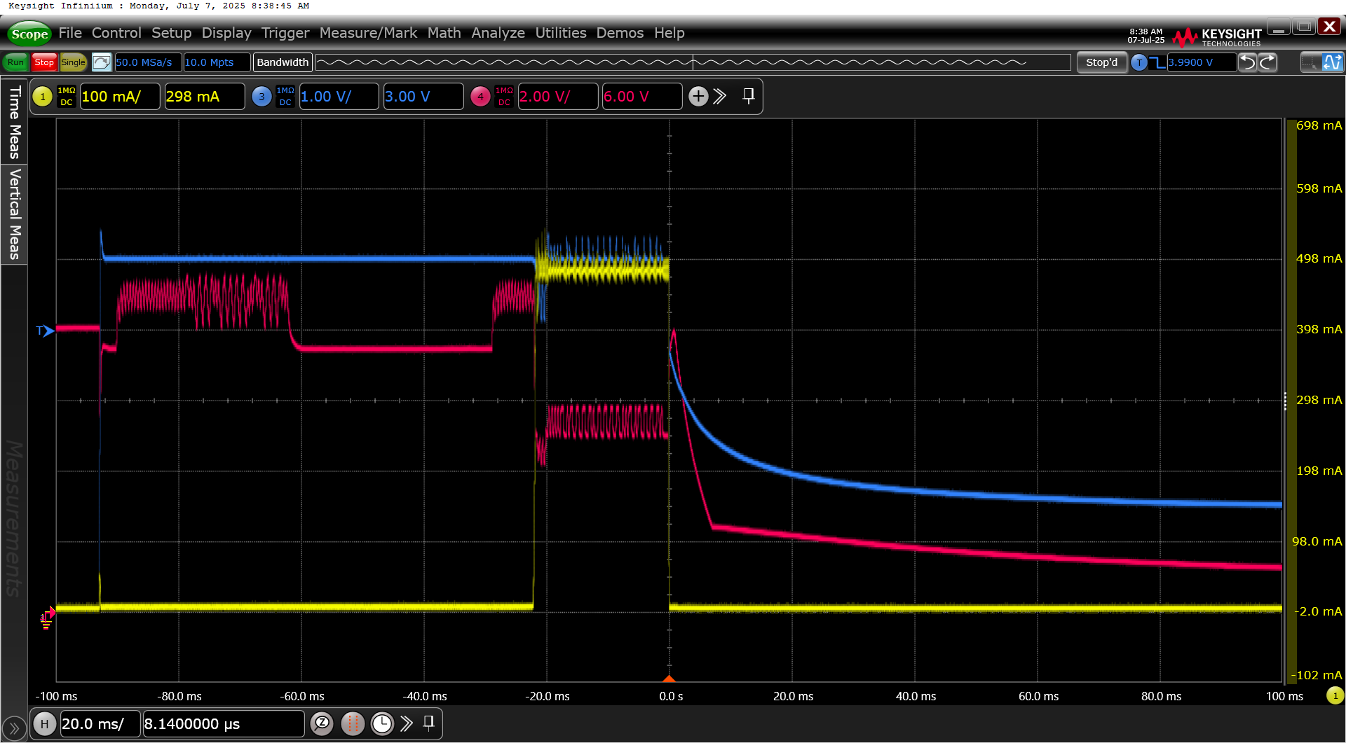

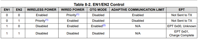

A new issue with BQ51013C has arisen: the IC only operates correctly when the adaptive communication limit is disabled (EN2 = 1). When the adaptive communication limit is enabled, the IC shuts down after a few milliseconds.
 Could you explain how the adaptive communication limit functions? I would prefer not to disable it in the final design, as maintaining wired power as a priority is important to me.

  • Hi Bill,
    I observed that when the adaptive communication limit is enabled, wireless charging stops after a short duration, typically between 40 ms and 90 ms. However, when I disable this feature, charging proceeds without any issues.
    Based on your explanation, I would expect the adaptive communication limit to restrict the output current, but not to terminate charging entirely.
    Thank you.

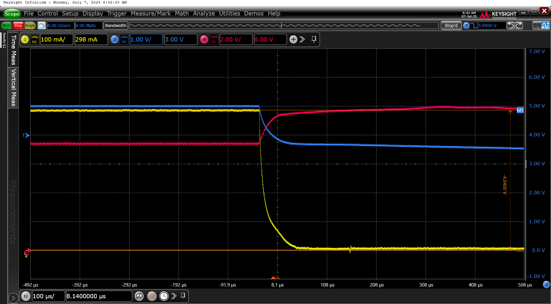

  • Hi Bill,
    Could you clarify what you mean by "voltage drops far enough"? As shown in the images below, the unit shuts down with an output voltage of 4.8V.
    The unit seems to perform better without it, but I would prefer to prioritize wired power over wireless (EN1 and EN2 = 0).

  • Hi Joao
    The voltage drop does not look like the output or RECT going undervoltage and triggering a reset.  The reset is occurring after the communications packet this could be due to overshoot on output, or end power transfer command.
    During power transfer the control error packet is set every 250ms, only need one good packet every 1.5 seconds.
    For large output error the control error packet is sent every 30ms, this looks like what may be happening.
