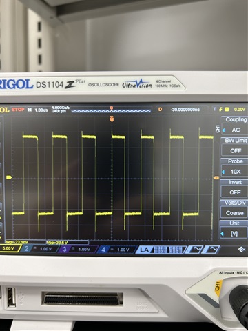

My TPS55340 boost converter's SW node is ringing quite a bit, contributing to audible noise and EMI.
12 V in, 24 V out, 0.5 A out
Here is the layout and schematic:
Inductor is FXC0630-100M.
Any recommended courses of action? Thanks!

    The switching node waveform is not stable. That means you may have a bad loop.
    Please check the loop compensation with SLVC430  TPS55340 Boost Design Excel Spreadsheet Tool.

  • Thanks for the reply. I was indeed using ground spring for scope measurement.
    Here is Bode plot from the current components (Rcomp = 10.7k, Ccomp = 33n, Chf = 47p, Cff = 120p):
    And after tweaking the values using the application schematic from the datasheet (Fig. 8-1) (Rcomp = 2.55k, Ccomp = 150n, Chf = 150p, Cff = 120p):
    Looking at total phase/gain, it looks more stable, as before 0dB gain occured near the knee of the phase plot. Lowering Rcomp seems to improve things even more. Is this sufficient?

    Is there too much parasitic inductance in the layout, or perhaps not enough output capacitance?

  • Hello, I added a 330 uF electrolytic to the output, and although the audible noise reduced considerably, the ringing on the SW node is still present.
  • Hi, it was indeed the compensation loop. I had an 0402 1kΩ resistor on hand and replaced the 10.7k Rcomp resistor with 1k; ringing went away on SW node, no audible noise, output ripple went from 3-5% down to <1%, and efficiency climbed from 84% to 92%. Here is the SW node now, under full load:
