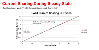

I have a question about the Device TPS26601.  We want to set the I(CB) at 3.3A when MODE=open to use it as a circuit breaker. However, we realize TPS26601 has a max limit on I(CB) of 2.4A.  I’m wondering if I can hook up two TPS26601 in parallel with R(ILIM) set to give I(CB)=1.65A for each eFuse.  So that I can total pull 3.3A at max before the device turns off (MODE=OPEN).  Our concern is does the device going to pull current equally out or there will be some internal resistance inside TPS26601 prohibit them pulling current equally at 1.65A each?
