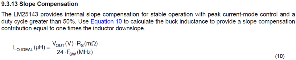

    However, like the LM5148, it is peak current mode control, and the same slope compensation explanation is written. When I used the LM5148 under the aforementioned conditions (Vin=24V, Vout=21.5V, fsw=300kHz, L=3.3uH), subharmonic oscillation occurred, so I think the LM25145 will also oscillate.
  • Hi User,
    Can you share where you simulated and got subharmonic oscillations? Sub harmonic oscillations because of improper slope compensation - which can be avoided if the device and the design are designed well.
    Furthermore, subharmonic oscillations is a property of current mode control scheme. LM25145 is a voltage mode control device which doesn't have subharmonic oscillation.
    Taru
    The reason why subharmonic oscillation occurred in the actual measurement of LM5148 was because the inductance was smaller than the recommended value. This can be improved by increasing the inductance or increasing the switching frequency, but the component temperature will not meet our criteria.
    I was looking at a different datasheet. As you say, the LM25145 is a voltage mode control device.The LM25145 seems to meet the usage requirements.

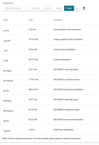

    -If the component temperature is too high with one LM25145, I would like to generate one 21.5V output using two LM25145s. Is interleaved operation possible?
    I dont think there will be thermal issues here. Please see the WEBENCH design that I shared earlier
    and use the design calculator of this device to get an idea of the kind of power dissipation expected.
    And to answer your question completely - yes, the LM25145 does support interleaved operation. You will find the details in the datasheet.
