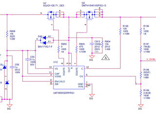

We use the LM7480 to protect against overvoltage, overcurrent, and load dump, and we have confirmed that it is functioning properly.
With the following circuit

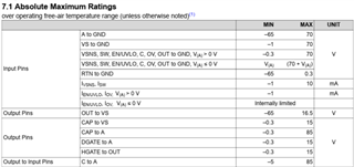

The absolute maximum ratings of the device are specified as -0.3V to 15V between DGATE and A terminals as shown below.

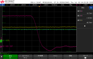

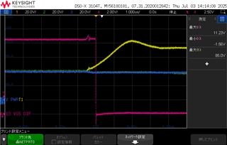

There is an undershoot of about 10 ns between the DGATE  and A terminal at a moment below -0.3 V.
CH1:Yellow:Power input
CH2:Green:Q3 FET source(A pin)
CH3:Blue:Q3 Drain
CH4:Red:Q3 Vgs
The right-hand windows, from top to bottom: VGS maximum , VGS minimum , Power input maximum.
Since this is being measured with a high voltage differential probe, it is possible that the capacitance or inductance of the probe is affecting the measurement.
