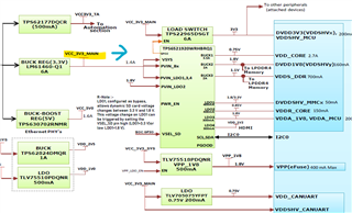

In EVM called "SK-AM62-LP", we have TPS6521920WRHBRQ1 bundle with AM620-Q1 MCU.
We need to evaluate the total system current consumption including PMIC.
1. Under MCU partial I/O mode, MCU will pull low the EN pin of the PMIC, may we learn the power consumption of the PMIC with 3.3V VIN at this moment?
2. From the State machine that once we pull the EN pin LOW, the PMIC should disable all the output rails(BUCKs/LDOs), in that case, it's defined as INITIALIZE state?
In above item 1 that I think below table is what we need but we need it based on 3.3V input.
