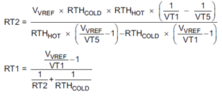

I want to adjust the error of the temperature sensor.
I want to perform RT1 and RT2 calculations, but what are the values of RTHCOLD and RTHHOT in the following equation?
I searched the specifications but couldn't find it.
Hi Okashita,
It will need to be the resistance value from the Thermistor datasheet.
