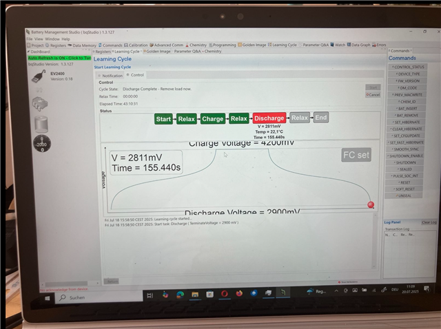

    I think, I managed to start a learning cycle. After 24h the battery was discarded. Unfortunately, the software stopped to do anything, it just showed the last measured voltage. I left the system in that state for > 10h but there were no changes (see screenshot).
    Even as the status diagram looks like, we were going through a full relax charge relax cycle, the state jumps very quickly (with in a few seconds) to the discharge state.
    Is there something obvious, I'm doing wrong or that I'm missing?

  • Now, I managed to start from the beginning. The first relax cycle finished and I started the Charge cycle after an hour, the battery was fully charged, but does not reached the nominal Charge Voltage of 4200mV, but only 4181mV. So bqStudio still thought, the device would be charging. I left the system in that state for > 3 hours without any change. The Cycle State showed: "Charge Mode - Connect charger now." for the entire time.

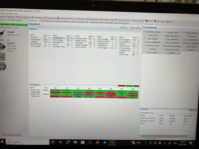

  • The description of the "Learning Cycle" starts with 3.1. "Initial Qmax Update Criteria". According to the documentation (SLUA903), we should send a GAUGE_EN command. I can not find any way to send such a command nor does the reference manual mentioning such a command. Is there an alternative command, we have to issue? I want to prevent us from loosing another day just to find out at the end of the discharge / charge cycle, that the learning was not successful.
    Please keep in mind, that I am (as a software engineer) not an expert in battery gauging (nor are our hardware engineers).
    Edit: I discharged the battery, disconnected charger and load and waited. I waited for ~6 hours now, the voltages was at 3137mV for over 60 minutes. Now, it looks like the voltage is even dropping (3136mV). Still, the RUP_DIS bit is still set (I assume, that the RUP_DIS flag is the equivalent of of the RDIS flag described in SLUA903. Is the battery now relaxed or not?
    Sorry, but I need somehow _precise_ instructions to perform the required "Learning Cycle".
    A desperate customer
  • Pleas find also a screen shot showing the current status attached:
