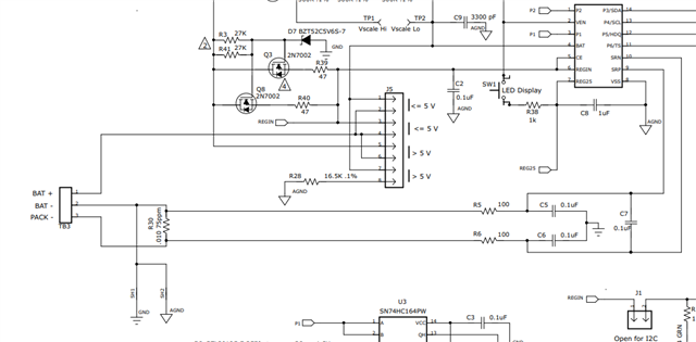

    In the following above circuit in EVM it is specified that BAT- and PACK-,Both are same right, When use separate discharge path we can connect to the pack- ,B- or else we can use only B+ and B_ right for sensing the current ?.
    BAT- and PACK- are not the same thing. Notice how in the EVM the sense resistor is placed in between Pack- and BAT-.
    No, you must use BAT- and PACK- to sense current.

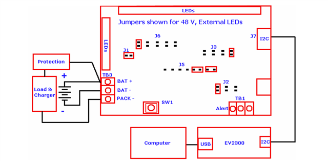

    So we can connect the charger of the battery pack and load to this PACK-,so the current can be measured.
    Yes, please follow the diagram you shared.

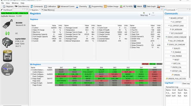

    I have connected the Bq34z100-r2 EVM using EV2400 ,Few issues i am facing which is listed down below
    1.When connected through EV2400,the Gauge is not Auto detecting, We need to open Bq Studio- Gauge  -then IC (bq34z100).In EVM datasheet it is stated that it will be auto detected.
    2.We are using NCR18650BD cell and i have updated the correct CHEM-ID ,And when trying  to do learning cycle, the learning cycle fails. we have set the VOLSEL bit High ,charge current  threshold, design capacity etc as suggested in learning cycle document .also in evm we have set 16V Jumper selected(BAT voltage-16.4V)and the we have given following commands stated in TRM for doing learning cycle.
    3.When battery is discharged to empty, and made to relax for 5 hrs and when started charging at C/2,VOK does not set automatically. during learning cycle.
    The battery discharge and when we put 5Hours relaxation, again we have charged the battery, The FC bit set so early and charging also happens.
    The remaining capacity and full charge capacity is also showing wrong values.
    Kindly give us a solution to proceed further.

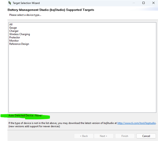

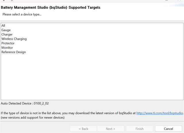

    When you open BQstudio you should get a list of .bqz files, under this list there is a section that says "auto detected device:", what does it say next here?

  • Hi Diego
    W..r.to
    1.The window detects the gauge and when selecting it's opening,
    We have calibrated the voltage , current and temperature before going the learning cycle.
    While charging FC BIT automatically sets during mid voltage in the learning cycle.Also when the battery is fully charged,the gauge shows the capacity as 300mah(full capacity), suddenly when the power supply is off the mah decrease to 70pmah and showing a discharge current of 20mA.
    BQstudio is not automatically opening because you are missing the correct .bqz, what does it say next to "auto detected device"

  • Hi
    The window shows as follows and auto detected Device is as follows

    Place the file attached in BatteryManagementStudio -> Config
    https://e2e.ti.com/cfs-file/__key/communityserver-discussions-components-files/196/3005.0100_5F00_2_5F00_02_2D00_bq34z100.bqz

    Could you Share me the link to upload the file
    The link has expired.
    You need to place the .bqz file I attached within the BQstudio folder on your computer. I am not sure where you chose to download this. The folder is named "BatteryManagementStudio", inside this folder there is another folder named "config", place the file I attached inside this folder. After this the next time you open BQstudio , your device will auto detect and BQstudo will automatically open.

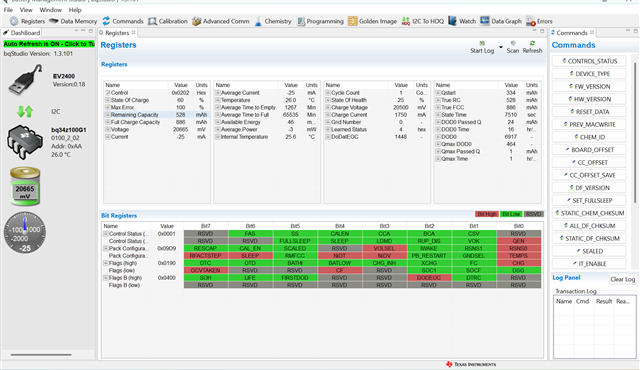

  • Hi
    We have started learning cycle for 5S1P pack,In this we have discharged the battery ,relax for 5 hrs and then charged,
    The battery is charged and the when put under idle case ,The Fuel Gauge shows -25mA discharge current taken from battery to discharge.
    Kindly help us to solve the problem.
    You can fix this issue 2 ways.
    1) increase your deadband
    2) calibrate the offset out, either using normal calibration, board offset, or CC offset
