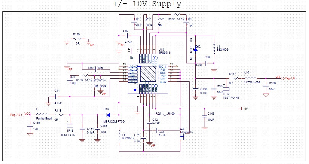

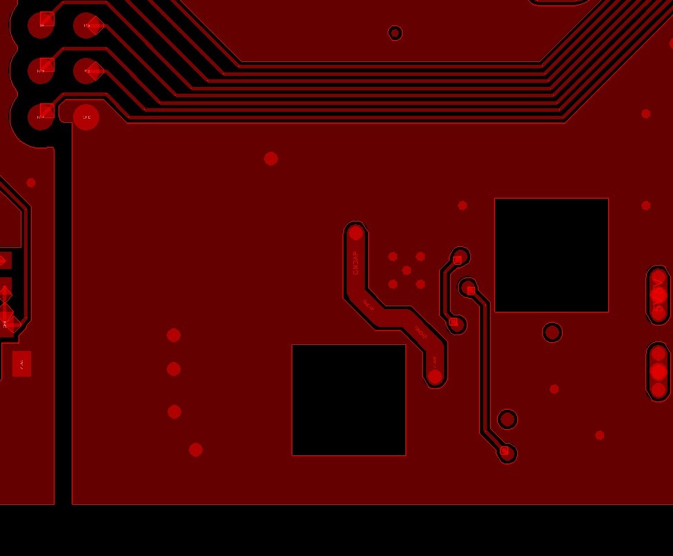

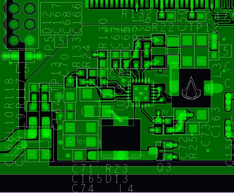

Hi everyone!
I used the TPS65131 in my project to have a dual power supply following the application notes and the routing of the evaluation board. When I power the board I hear an annoying buzz. I checked the schematic, PCB, power supplies and everything else but I didn't find any particular inconsistencies. If I put my finger on C70/R133 the noise fades a lot becoming almost imperceptible.
Any ideas on what it could be? Incorrect sizing? Incorrect routing? What tests can I do to understand where I'm going wrong? The integrated circuit seems to work correctly with the correct input and output voltages.
Below I post the electric diagram, the layout and the BOM.
Thanks to anyone who can help me.

  • Hi HXC,
    Could you please capture the waveforms of VPOS and INP?
    Seems you only added one 4.7uF as the output cap of VPOS which might be too small, you can try adding more capacitance as well.

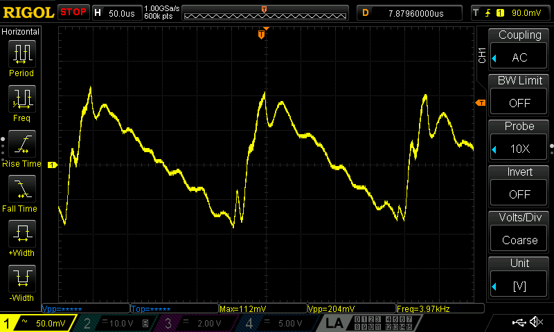

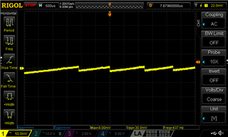

  • Hi Patrick,
    thanks for your feedback.

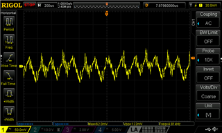

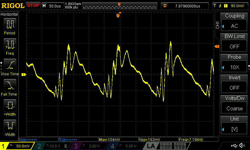

    Attached you'll find captures of
    -INP as design
    -VPOS as design
    -VPOS + 4x10uF X7R
    Adding capacitors on top of C71 relaxed the ripple frequency but didn't changed at all the audible noise.

  • Hi HXC,
    When increasing the load current, will the audible noise have improvement?
    BR
    Patrick

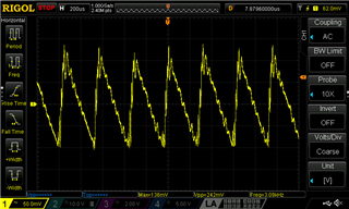

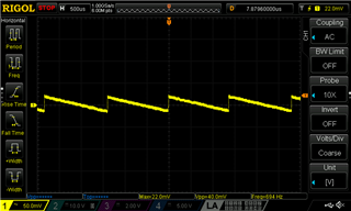

  • Hi Patrick,
    without load (removing R118 and R117) noise is significantly reduced, almost inaudible. Current absorption is about 20mA +-10% on both channels
    Below you can found waveform of the output with and without resistors
    Salvatore
    VNEG - VPOS
    VNEG NO LOAD - VPOS NO LOAD

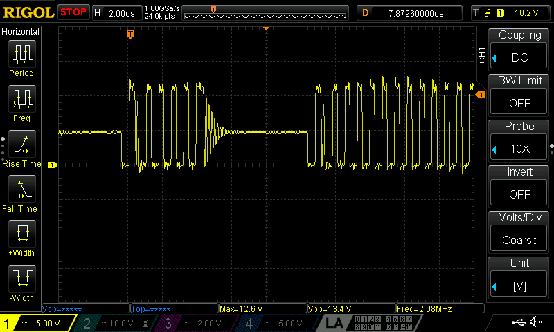

    Are you able to capture the load current waveform? Since removing the load can reduce the audible noise so I suspect the voltage ripple maybe caused by the inrush current.
    It will be helpful if you can also capture the inductor current waveform to see whether it has low frequency oscillation.
