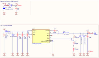

I am facing an issue with a LMR33630ADDAR (HSOIC) buck converter (24 V input to 5 V output): the IC is instantly destroyed (short circuit between SW and VIN) as soon as I apply the input voltage.
Interestingly, the same schematic works fine in another project/layout and is also similar to the reference design.
What I have checked so far:
  • Schematic and BOM carefully reviewed, multiple times
  • FB and EN pins correctly connected (confirmed both in schematic and layout)
  • PGND and thermal pad properly connected to ground
  • Input protected with a 33 V Zener diode (to clamp voltage spikes)
  • No output short circuit, no visible assembly issues
Question:
  • Is there any mistake I have overseen?
This is the schematics of the non working pcb
and this is the layout:
If you need more informations, feel free to ask!
Any feedback or experiences would be highly appreciated!
