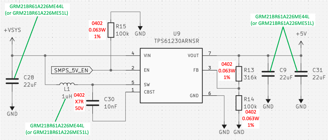

Just checking that I can use 0402 for the resistors and 10nF capacitor for the TPS61230A (with an output voltage of 5V)
The other components in green text are the recommended parts from the datasheet, the components in question are shown in red text...

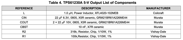

However, the resistors for setting the output voltage, in this case R13 (316k) and R14 (100k) are recommended to be 100mW in the datasheet.
Yet when I calculate the power dissipation for these resistors the power is less than 100uW.  So I assume 0402 63mW should be fine ?
