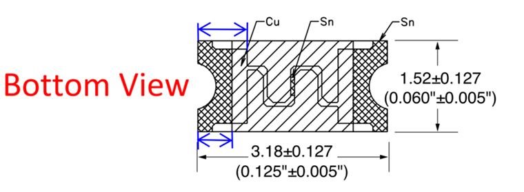

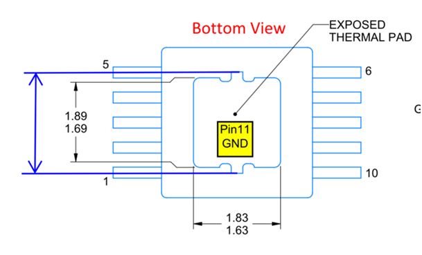

Due to internal document requirements, I would like to ask what is the maximum value of Thermal PAD (blue icon) in the attached TPS7A43 spec.
The attached footprint does not appear to correspond to the TPS7A43. Can you clarify your question please?

I'll forward this question on to our packaging group to see if we can provide a typical value for that dimension.
Alex Davis
I've passed this on to the packaging team and will update when I have more information
We do not specify a typical value for the indicated dimension. These small tabs do not impact solderability and are usually covered by mold flash in the packaging process. For solderability, the outer dimensions of the thermal pad can be considered to be the 1.69mm to 1.89mm dimension indicated in the drawing.
