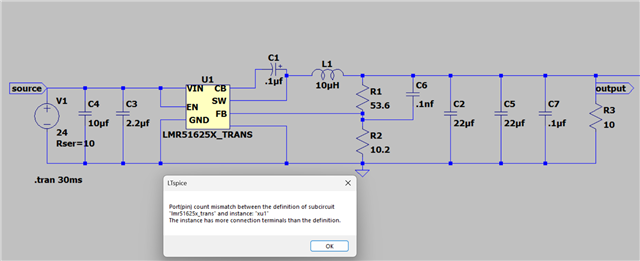

During the simulation in LTspice, an error is displayed. We have also verified the pin details and pin names.
Could you please recommend a solution for the simulation of the LMR51625 IC?
Hello Sanjay,
Thank you for considering our products in your applications. Sorry we do not support LTspice mainly due to copyright issues. Could you please simulate with Pspice? There is also a free version of Pspice-for-TI
