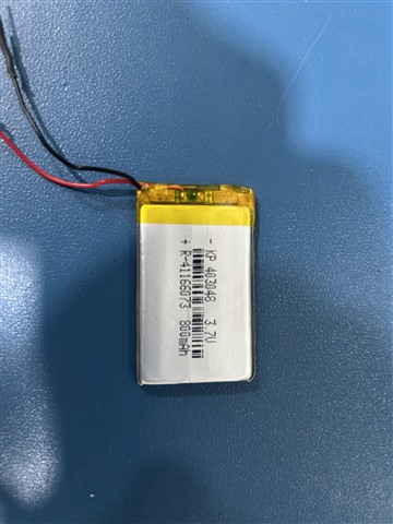

  • hello  ,
     attached my battery pic for battery specification.
    (1) when my battery voltage read by multimer , reading =0.008v and when we try this battery to charging(CE low CHG_EN=0),at this time ADC value of VBAT read 4.226v constant through out the complete charging.
    (2) for the given battery in pic we charge it with logice given below.
    uint8_t reg_val_t = 0;
    reg_val_t &= ~(1 << 2);
    write_register(0x19, reg_val_t); // (function argue = register address,value)
    uint8_t buf=0xA0;
    write_register(0x06,buf);
    uint8_t reg_02=0;
    reg_02=(reg_02 & 0x3F) | (0x01 << 6);//3000mA
    // reg_02=(reg_02 & 0x3F) | (0x03 << 6); //2000mA
    uint8_t reg_03=0;
    // reg_03=(reg_03 & 0xF0) | (0x04); //2000mA
    reg_03=(reg_03 & 0xF0) | (0x09); //3000mA
    write_register(0X02, reg_02);
    vTaskDelay(pdMS_TO_TICKS(100));
    write_register(0X03, reg_03);
    here we try to set REG0x19[2] = 0 ,set REG0x06= = 0xA0 and i want set 3000mA in (REG0x02).
    problem is battery charged fastly(15 min) upto 3.8v then to reach 4.2v take 1.5 hour
  • Hi Ravi,
    Please see my comments below.
    1) Your observation leads me to believe some form of battery protection has been triggered, such as an over-discharge protection. Often battery protection ICs will disconnect battery from charger and in this case BQ25622 measured BAT pin connection as open and it will very quickly charge the output capacitor up to 4.2V VREG setting. I recommend you check what is required method to close battery protection IC to allow the battery to charge as expected.
    If battery voltage was in fact 0.008V BQ25622 would start charge from trickle charge phase rather than quickly charge up BAT pin output to 4.2V.
    2) To set 3000mA ICHG you will need to set 16-bit REG0x02 = 0x980. Put another way this would be 8-bit REG0x02 = 0x80 and REG0x03 = 0x09. Regarding charge cycle firstly, for your information it is expected that the CV phase of charge can take a long time relative to the CC phase of charge depending on configuration of charging parameters.
    With that said, you can also expect shorter charge time with a more optimized hardware setup. Large IR drop across path from BAT pin to actual battery terminal will result in early entry to CV phase and cause longer charge time. Please check 'CHG_STAT" bits in REG0x1E when your battery reaches 3.8V to confirm whether device is entering CV phase at this time. For example, using shorter wires between BQ25622 and the battery cell should result in shorter charge time.
    Garrett

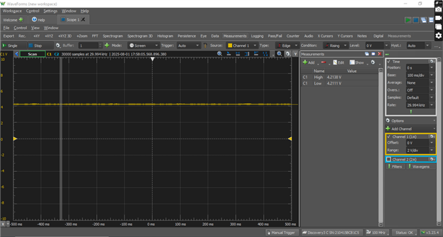

  • hello  ,
    (1) I attached my VBAT plot during charging. It taken initially and remains constant throughout the charging process. However, I believe the battery voltage should gradually increase, which I want to monitor using the ADC.
    Please guide us step by step how to read ADC for VBAT.
    2) We are still facing the issue of long charging time. The battery takes around 2 hours to fully charge, and the charging mode remains in taper (CV mode) throughout the process.

  • Hi Ravi,
    1) Yes battery voltage is expected to gradually increase. Do you have a capture which shows VBAT at same time input supply is connected/turned on? Also where are you measuring VBAT from in the plot?
    The ADC is turned on via bit 7 in REG0x26. Then to read VBAT_ADC output you simply need to read from REG0x30 then REG0x31. These two 8-bit registers combined output the VBAT ADC measurement.
    2) Please measure the voltage near the charger IC BAT pin with the battery still attached instead of measuring at the battery after removing it from the charging system. I am trying to understand the voltage difference between the charger IC output and the battery. By measuring the disconnected battery we do not know this difference.
     Please guide us with step-by-step instructions to achieve fast charging using the BQ25622.
    The device performs the charge cycle automatically. There is no step by step instructions besides proper configuration of charging parameters and optimizing hardware setup.

  • hello  ,
    here our vbat not changed when system reset its constant 3.9v , our vsys changed 1.8v just before reset.
    we set REG0x19[5] = 1b.  but not improvement
    please guide us with proper solution
  • Hi Ravi,
    Can you please provide a waveform of VSYS voltage, VBAT voltage (voltage measured at the BQ25629 BAT Pin), and VCELL voltage (voltage measured at battery cell in your battery pack) when the load to SYS is applied? Preferably with the 3 waveforms in the same capture?
    As Garret mentioned, a likely cause for this behavior and the previous behavior is high resistance between the BQ25629 BAT pin (VBAT_BQ) and the battery cell (VBAT_CELL). A high resistance will cause a voltage drop that is proportional to the current (VBAT_BQ - VBAT_CELL = IBAT * Resistance). So during charging (Positive IBAT) at high current VBAT_BQ > VBAT_CELL. During discharging (Negative IBAT) VBAT_BQ < VBAT_CELL. So even if VBAT_CELL is measured at 3.9V, it is possible that VBAT_BQ is at a lower voltage.
    The BQ25629 only monitors VBAT_BQ and can't monitor VBAT_CELL, so we recommend reducing the resistance between the two nodes as much as possible. This includes designing with wider PCB gauges and using larger gauge wires.
    Juan Ospina
  • hello  ,
    Can you please guide me on how to measure the battery level during charging? The VBAT ADC shows the voltage at the battery pin, which is not the actual battery voltage  during charging. Please provide a method to measure battery level while charging.
  • Hi Ravi,
    Since the difference between voltage at the battery pin vs actual battery voltage is cause due to the voltage drop due to resistance between those two points (I_battery * R_trace), the most recommended method for measurement is to minimize or eliminate charge current and discharge current for the period of time during the ADC read.
    Minimizing I_battery by pausing charging and pausing components with a heavy current load should reduce the difference between V_BAT and V_CELL read by the VBAT ADC. Additionally, minimizing R_trace in your design by widening traces and minimizing the distance between the pin and the actual battery may help in this performance as well.
    Juan Ospina
