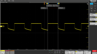

    1) Waveforms of the output attached.

    Thank you for sharing.  The waveforms do not appear to show output instability, at least at the 200ms/division scale, though it is possible there is a higher frequency instability (oscillation) in the output voltage that is not visible at this scale.
    It looks like the output is running for 230ms, then shutting down for about 100ms before restarting.  That is an unusually long restart delay for the TPS544B20.  Faults (Over Current, Over Voltage or Under Voltage) generally trigger a 7x the TON_RISE setting delay prior to restart, which defaults to 3ms without PMBus programming.
    One note on the schematic, you have CNTRL pulled up to VIN (12V) the maximum voltage on the CNTRL pin is 7V.  You should add a CNTRL to GND resistor to avoid pulling CNTRL up to 12V.  You could populate R1446 (to 3V3) to limit the pull-up, assuming 3V3 can sink current.  A resistor of 2.4kΩ or less would limit the CNTRL voltage to less than 5V and prevent it from being pulled up above 7V.
    It looks like your added capacitance has an additional 6x 100μF, which is bringing the total capacitance above 1,900μF, which would definitely bring the loop stability into question.  If that is indeed the issue, you should seen an oscillation in the output voltage when observing the output voltage at 10μs/division.  This might not be observable at 200ms/division.  But I would not expect a 100ms time-out to result.
    Given the time-out period, I would recommend looking at the CNTRL voltage, and the EN_1VD_MPL signal driving it.
