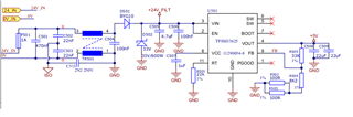

We used the part in our design as a regulator from  +24V input to +5V. When powered up for the first time with +24V applied and minimal load (around 50mA), it regulates to the intended voltage by around 20 seconds and then the input current rises, it stops to regulate the output and heat up dramatically. After that the device is permanently damaged and it does not return to the initial behavior if power off and on. We found out that if the input voltage is smaller than 15V, the catastrophic failure does not happen, at least in the observed time.
Please find the schematics below. We checked against the datasheet and could not find any discrepancies. The fact that it does work as intended for a small amount of time seems to be an indication that the general connections are ok. Also, we could not figure out what could cause such a catastrophic failure.
We also experimented increasing the input capacitance with a low ESR capacitor, to no effect. In one test, we applied the input directly to +24_FILT node, with the same outcome.

    If you are utilizing an input filter, it is important to ensure that the input filter is effectively damped (with an electrolytic capacitor with enough ESR), to avoid any runaway inductive ringing on input. Please see this application note for details on a damping capacitor (Cd in the application note).
    If this does not help, please send over the layout used so we may review this as well.

  • Thank you for the reply.
    We tested applying the input voltage with a lab power supply directly in the +24V_FILT node without the diodes, with the same result.
    Please find below the layout. It was done in a hurry, so some aspects of it are not ideal, but we can't figure out what could cause such catastrophic failure. Would you know of any cases of counterfeits for this part?

    Applying the input voltage directly at the 24V_FILT node can still be subject to extra inductance. Please see section 8.4 of the datasheet that delves into more detail about this.

  • Thank you for the observations.
    When we tested your suggestion in relation to runaway inductive ringing on input generated by the input filter we removed all circuitry related to the filter and placed a large very low ESR electrolytic capacitor in the input pins. The additional capacitor and the input voltage were applied very near the VIN. Please elaborate on how to properly perform this test to confirm this as a cause. We also probed the input and output and found no oscillation or spikes. The operation seems stable until 16V input.
    Regarding the layout notes, would you know how any of these items could cause the catastrophic failure observed? We did not observe any heat issues during the operation at lower voltages where it does regulate, and noise coupling in the feedback pins should interfere with the regulated voltage, or even make it not regulate properly, but not burn the device right?
    Any suggestions on how to narrow down what can be the cause? We cannot perform a layout revision without pinpointing the exact issue for the failure.
